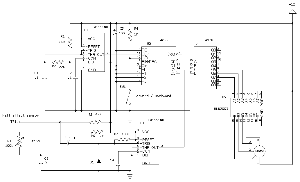

Hi, I hope you can read some english words.
U1 is an oscillator that drives the stepping motor (U6) at " a certain speed" thru the counter (U2) the decoder (U4) and the buffer (U5).
U3 is a single shot fired at each turn of the bobin by an Hall effect sensor (or anything else you already have to count the turns).
This single shot enables the counter so that the stepping runs for " a certain amount of time" each main turn.
I've choosen to have a constant speed (for constant torque) and to adjust the "certain time" using R3 and marked it in wire diameter units.
This is just for the idea, you probably nedd to alter values to adapt to your specific hardware.
Have fun, Ivo.
(You may ask questions in Italian or French, but I prefer to give answers in French or English, cos I've no technical Italian vocabulary.)

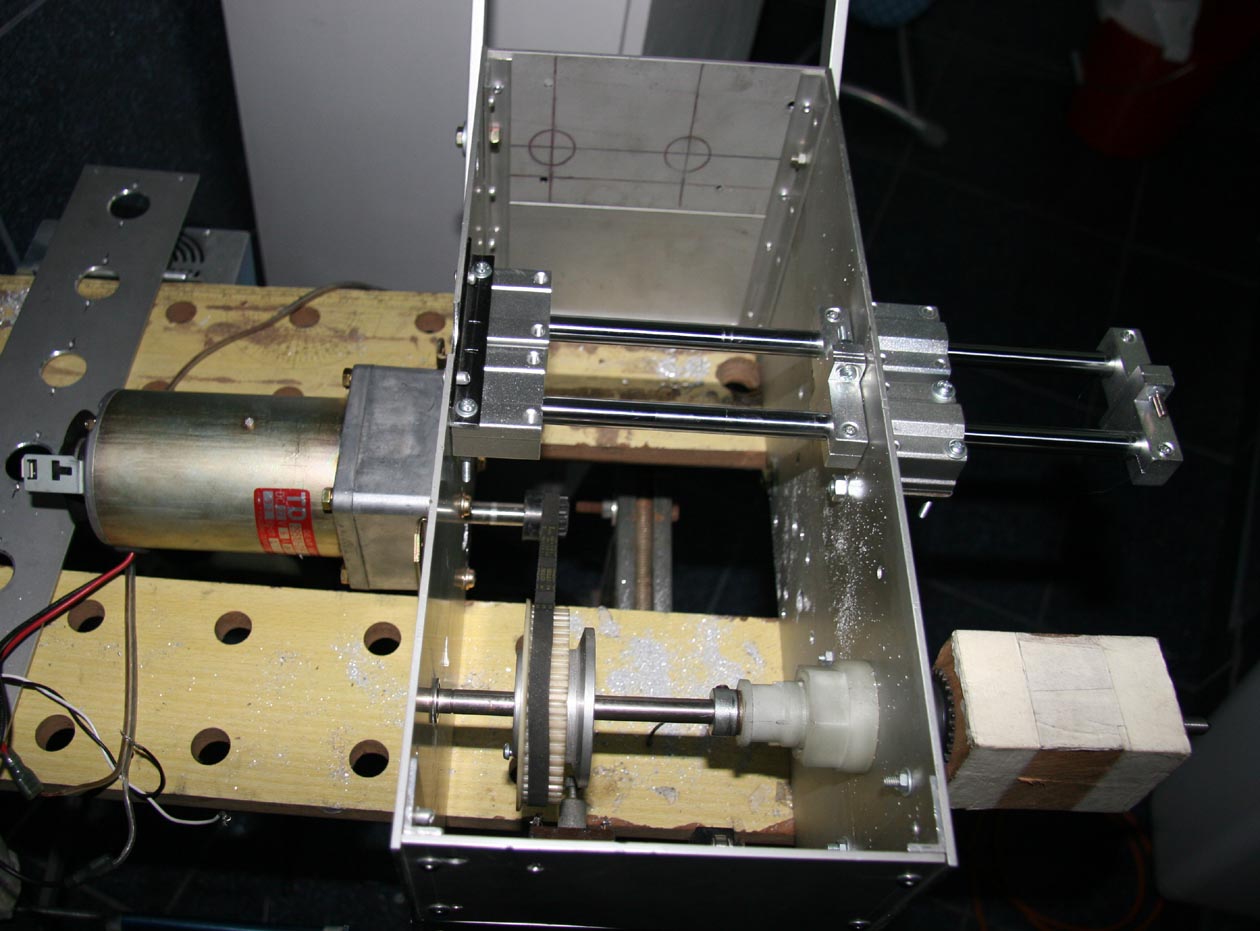

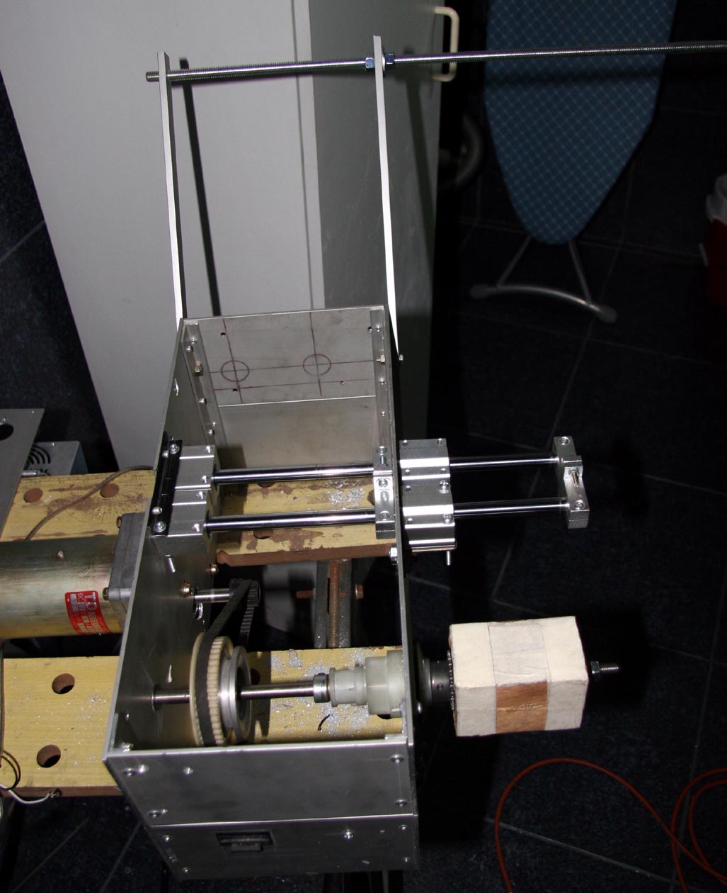

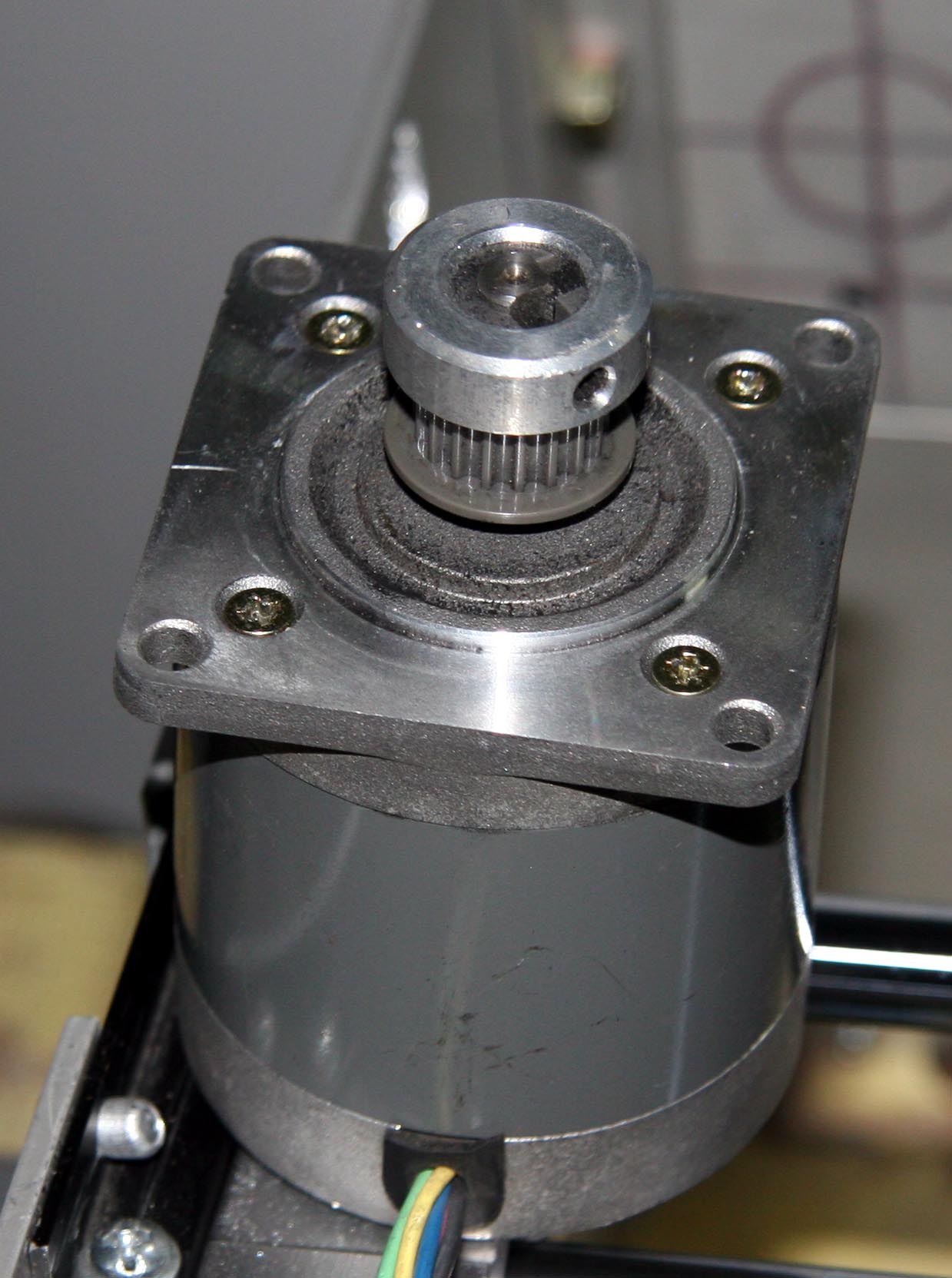

ciao, seguo la construzione, ho montato la vite senza fine per il movimento del carrello guidafilo, ho utilizzato una vite di un sistema di poltrona elettrica, ho intallato un motore passo passo per il movimento, motore che dovra essere sincronizzato con il motore del rocchetto, manca ancora il circuito elettronico di controllo che penso di terminare fra un paio di giorni, saluti dalmazio
