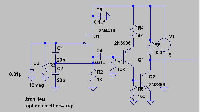

Hi,
From these links:- http://www.diyaudio.com/forums/showthre ... post301932
http://www.diyaudio.com/forums/showthre ... post301808
I've designed a clock but I haven't yet built it. I'm not too sure what transistors to use but when I modelled the circuit in LTSpice it worked !
I have attached the image:
Cheers,
Ashley. Immagine
